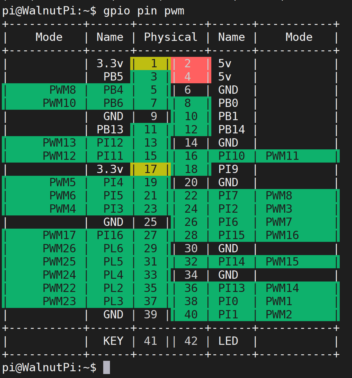

PWM (脉宽调制)​
PB4, PB6, PI10, PI11, PI12, PI2, PI3, PI4, PI5, PI6, PI7, PI15, PI16, PI13, PI14, PI0, PI1, PL2, PL3, PL4, PL5, PL6 提供硬件PWM功能。
查询指令:
gpio pin pwm
gpio
