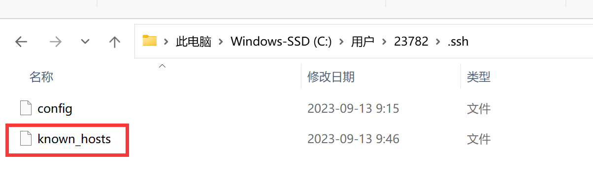

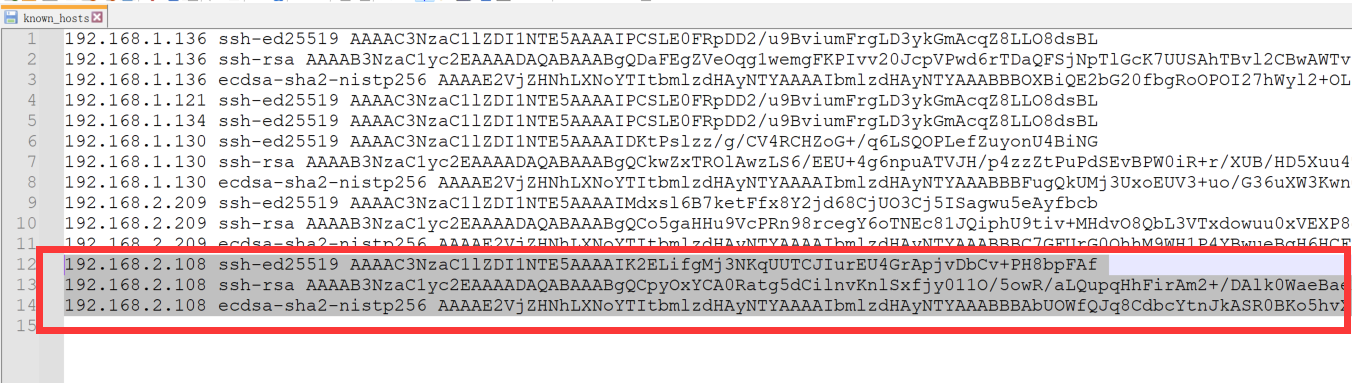

One common scenario: if you have previously used Thonny or VSCode to remotely connect to a WalnutPi, and then the WalnutPi has been re-imaged or its SD card replaced, you need to delete the SSH key information on your computer to reconnect.
For Windows users, this file is located at C:\Users[username].ssh\known_hosts
Open the file, find the current WalnutPi IP, and delete the IP and its key information.
ssh_error1
ssh_error2
