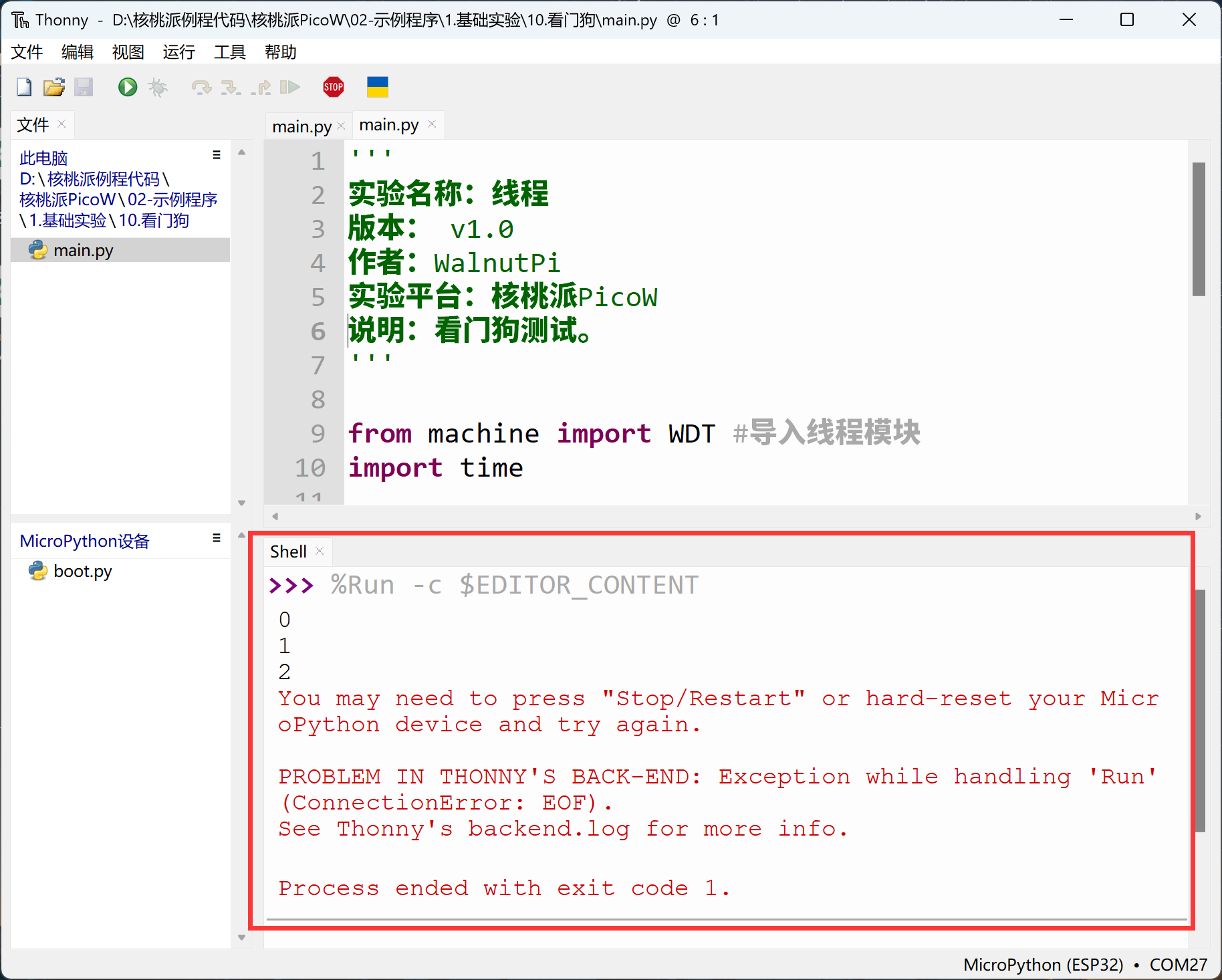

Experimental Results​
Run the code and you can see the serial terminal prints 3 messages, then automatically restarts.
