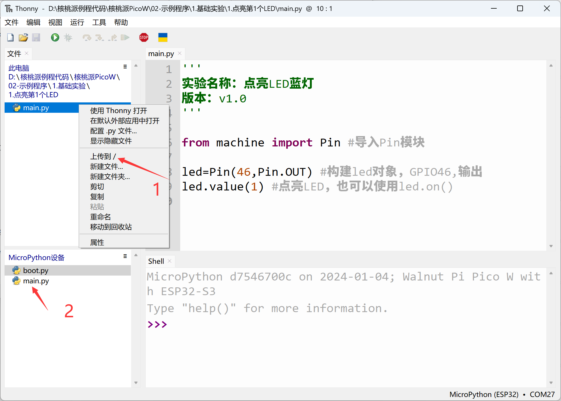

That means we just need to send the code as a main.py file to the development board, and the board will run the program automatically on power-up.
Send the LED example's main.py to the development board:
run_offline

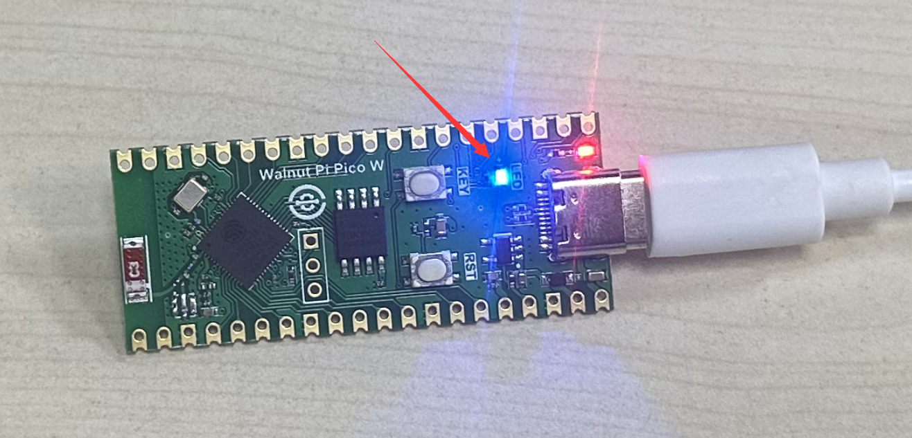

Then close the IDE and press the WalnutPi PicoW's reset button. You can see the blue LED on the WalnutPi PicoW lights up after each reset. The code is now running offline:
run_offline
Simply rename your code to main.py and send it to the development board to achieve automatic offline execution on power-up.
