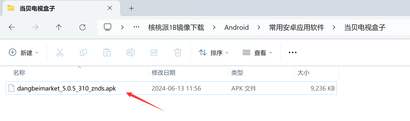

The Dangbei installation package is located in the 常用安卓应用软件 (Common Android Apps) folder inside the image directory:
tv_box

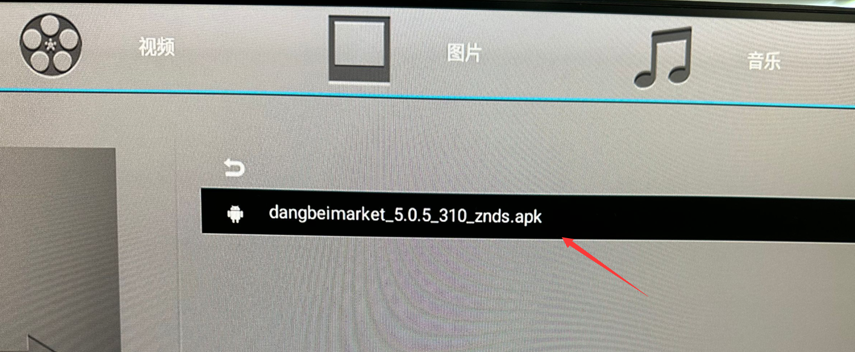

You can copy the app using a USB flash drive, then install it on the WalnutPi's Android system. Tutorial: USB Flash Drive File Transfer
Click the app:
tv_box

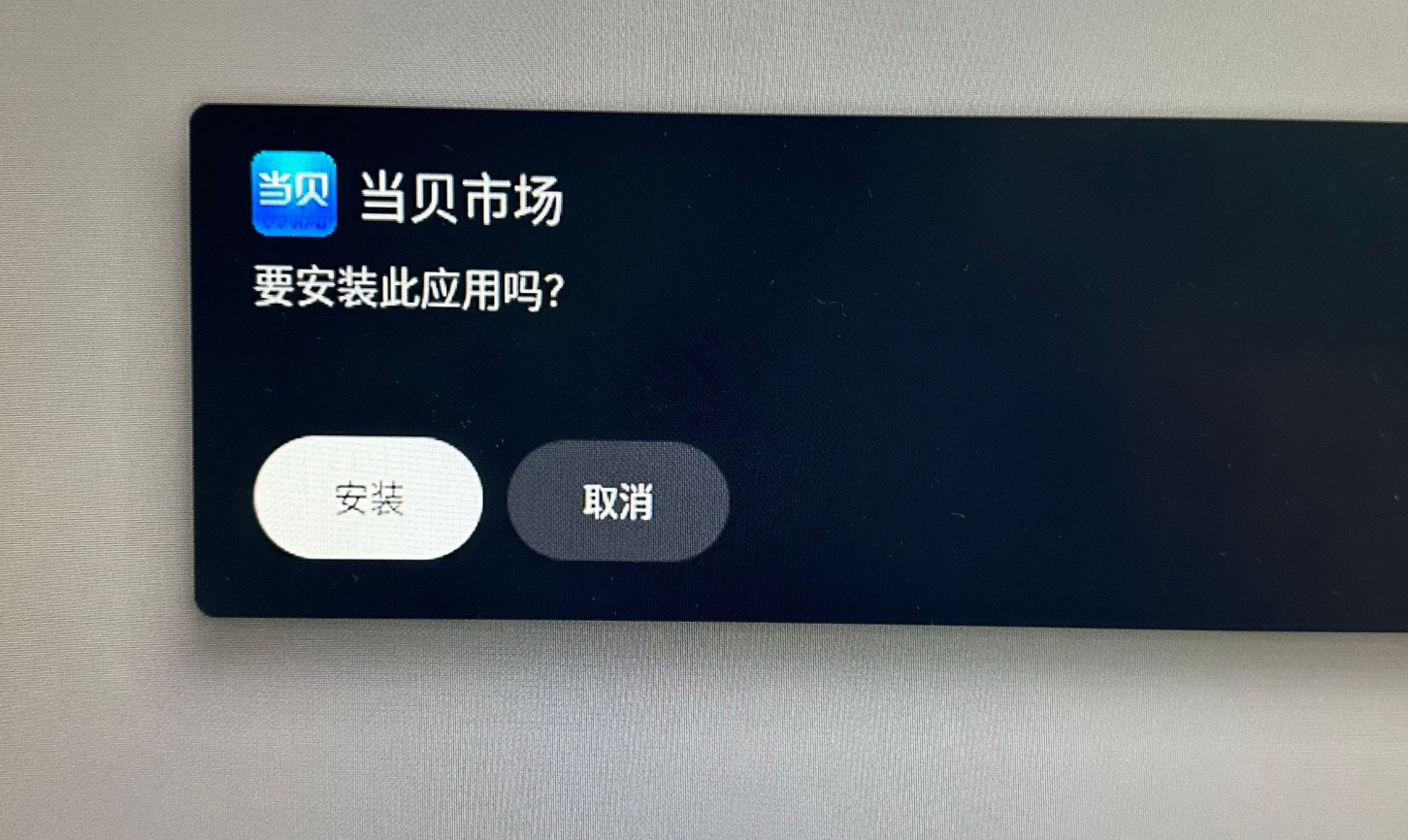

Then click Install:
tv_box

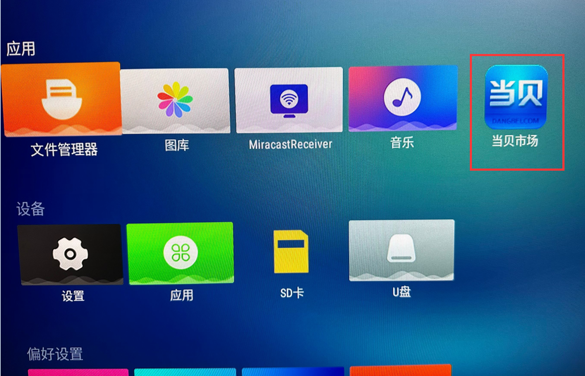

After installation, the Dangbei Market app icon will appear on the desktop:
tv_box

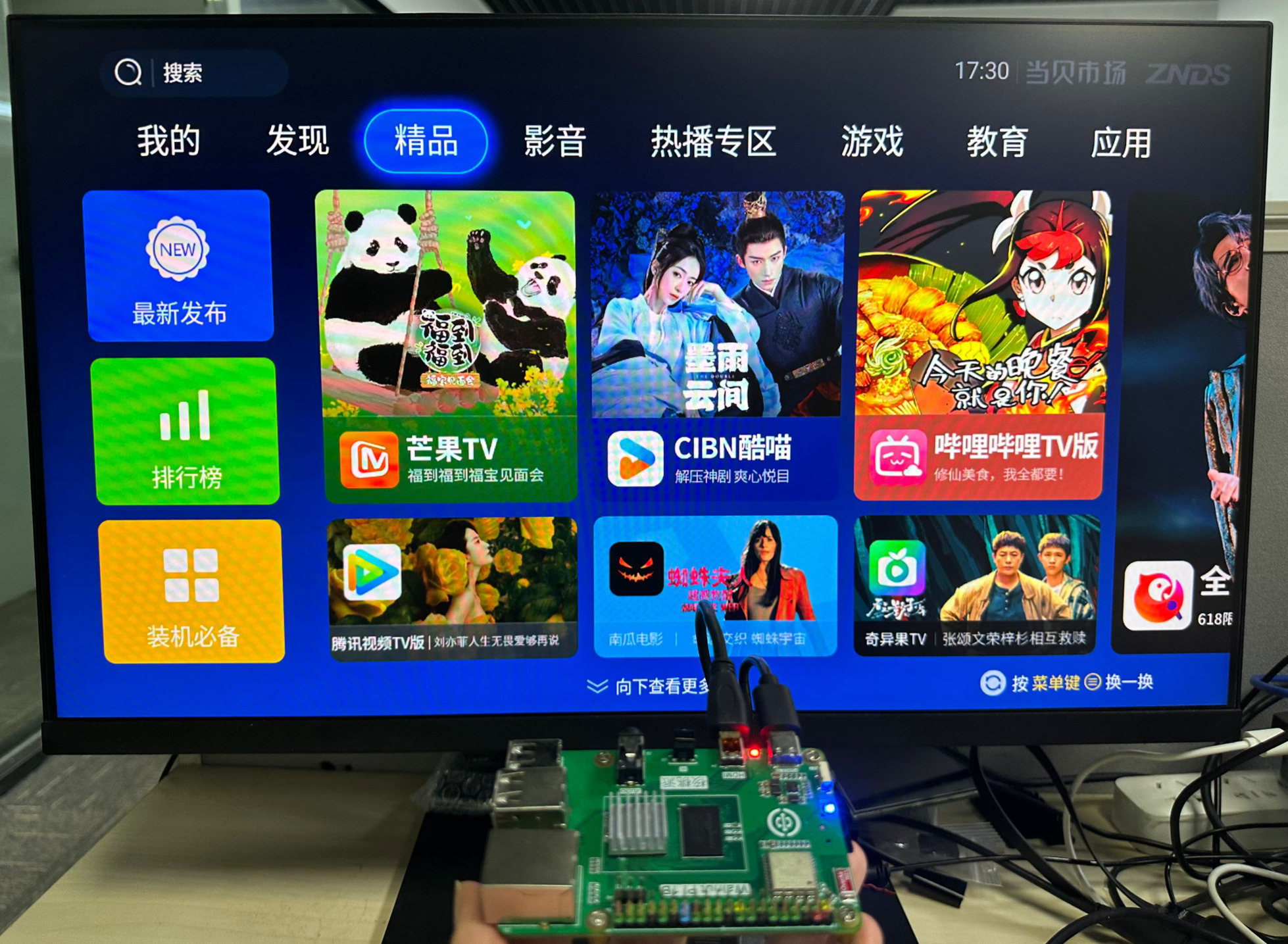

Make sure the WalnutPi is connected to the internet. Refer to: Connecting to the Internet
Then open Dangbei Market:
tv_box
