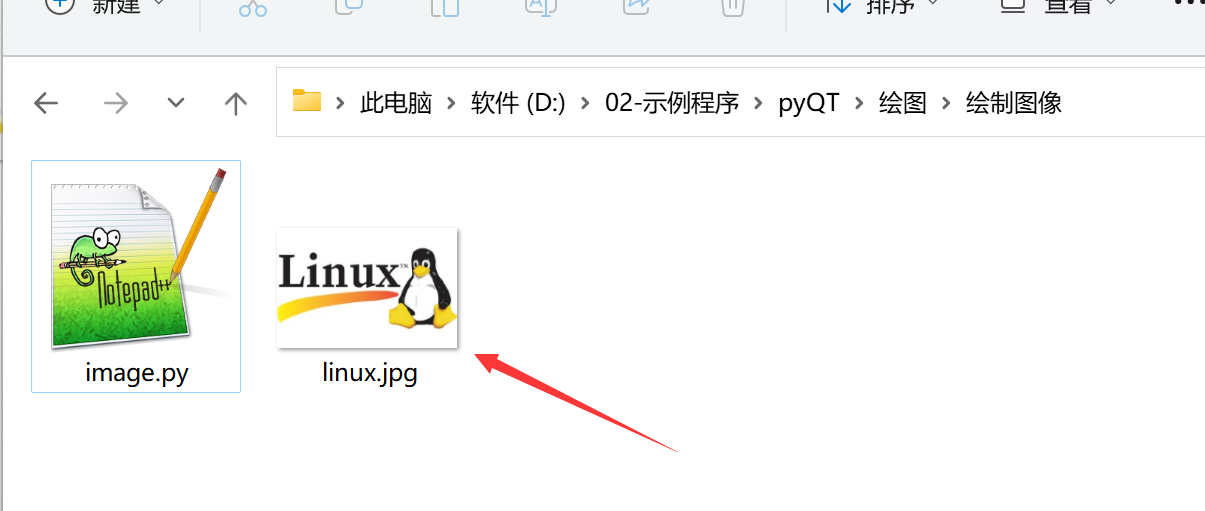

First, place the image you want to display in the same directory as the code:
iamge1

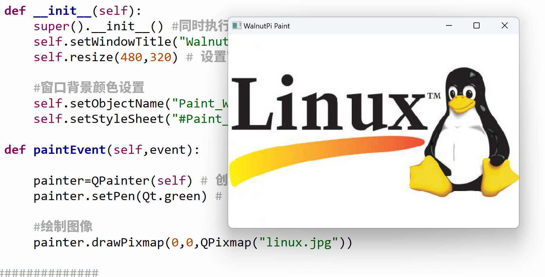

Run the code and you'll see the following result:
iamge2

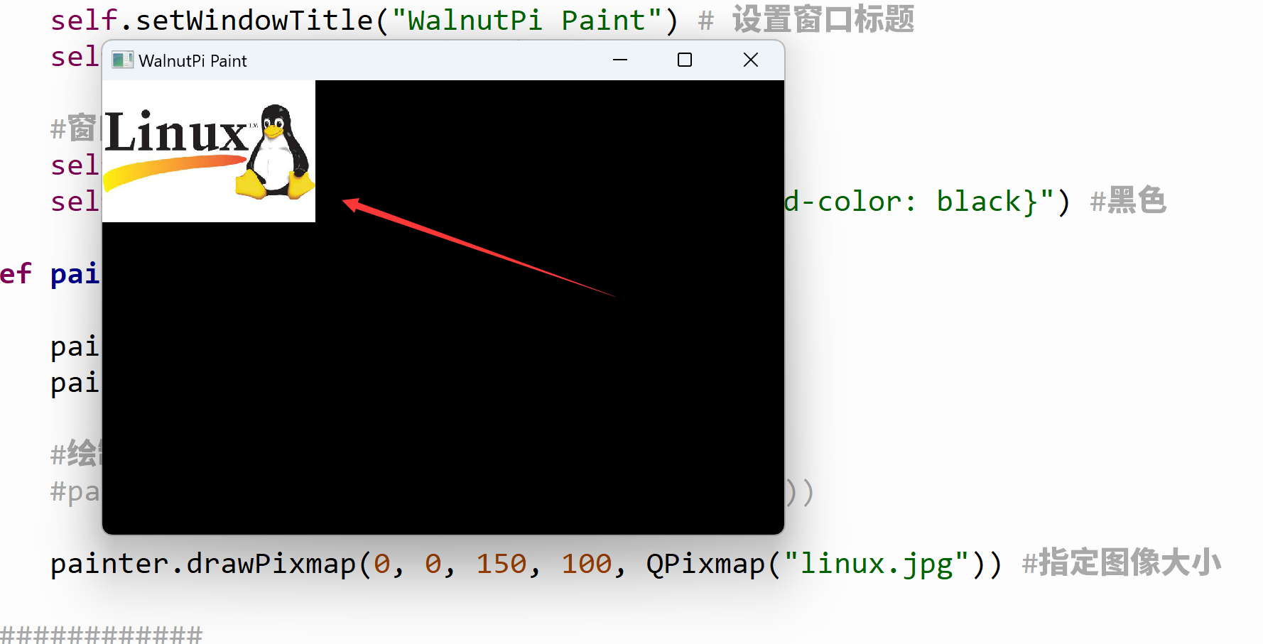

Modify the image drawing code as follows:
def paintEvent(self,event):
# Draw image
painter.drawPixmap(0, 0, 150, 100, QPixmap("linux.jpg"))
Run again — you can see the image size has been set to 150x100:
