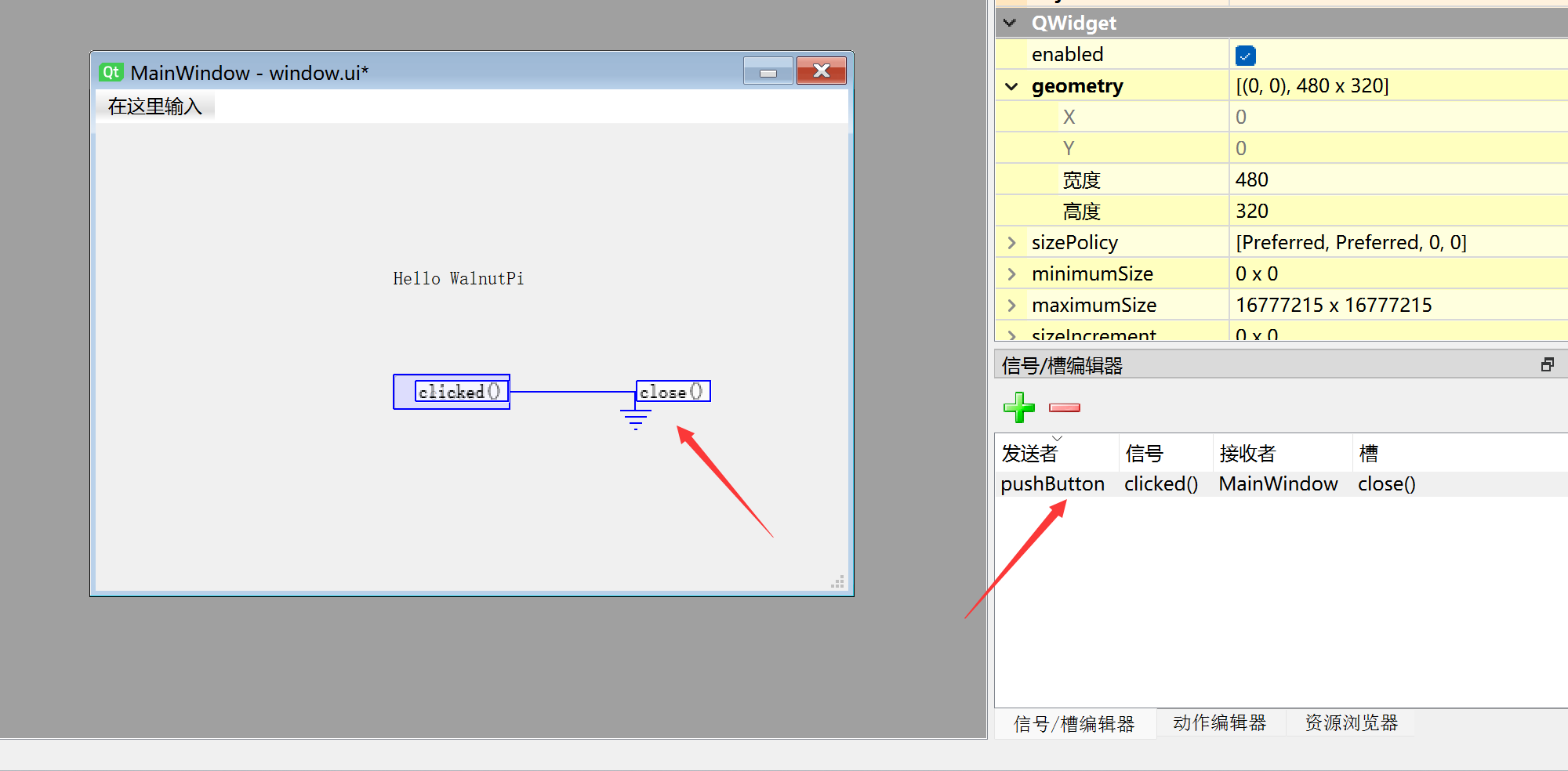

Now, here's the key step: click and hold the button with your mouse, drag it to an empty area of the window, then release. After releasing, it should look like this:
signal_slot5
A configuration dialog will pop up. Check Show signals and slots inherited from QWidget in the lower-left corner:
signal_slot6
On the left side is the button widget — click clicked(). On the right side is the main window — click close(). Then click OK.

You can see that both the main window and the Signal/Slot Editor in the lower-right corner now display the configuration we just set:
signal_slot8
