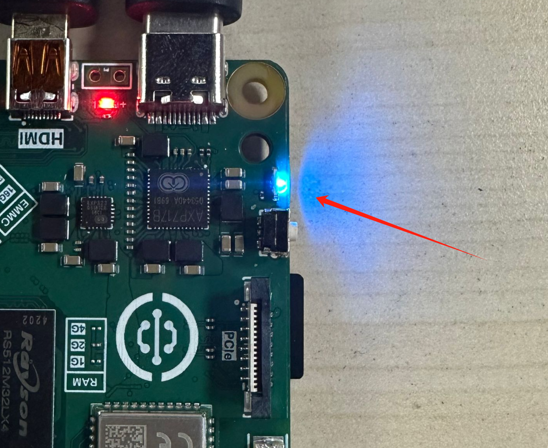

After completing the system image burning in the previous section, the microSD card will contain the WalnutPi Android system. Insert it into the SD card slot on the back of WalnutPi. After powering on, a solid blue LED indicates normal startup.

After normal system boot, the blue LED will remain solid.

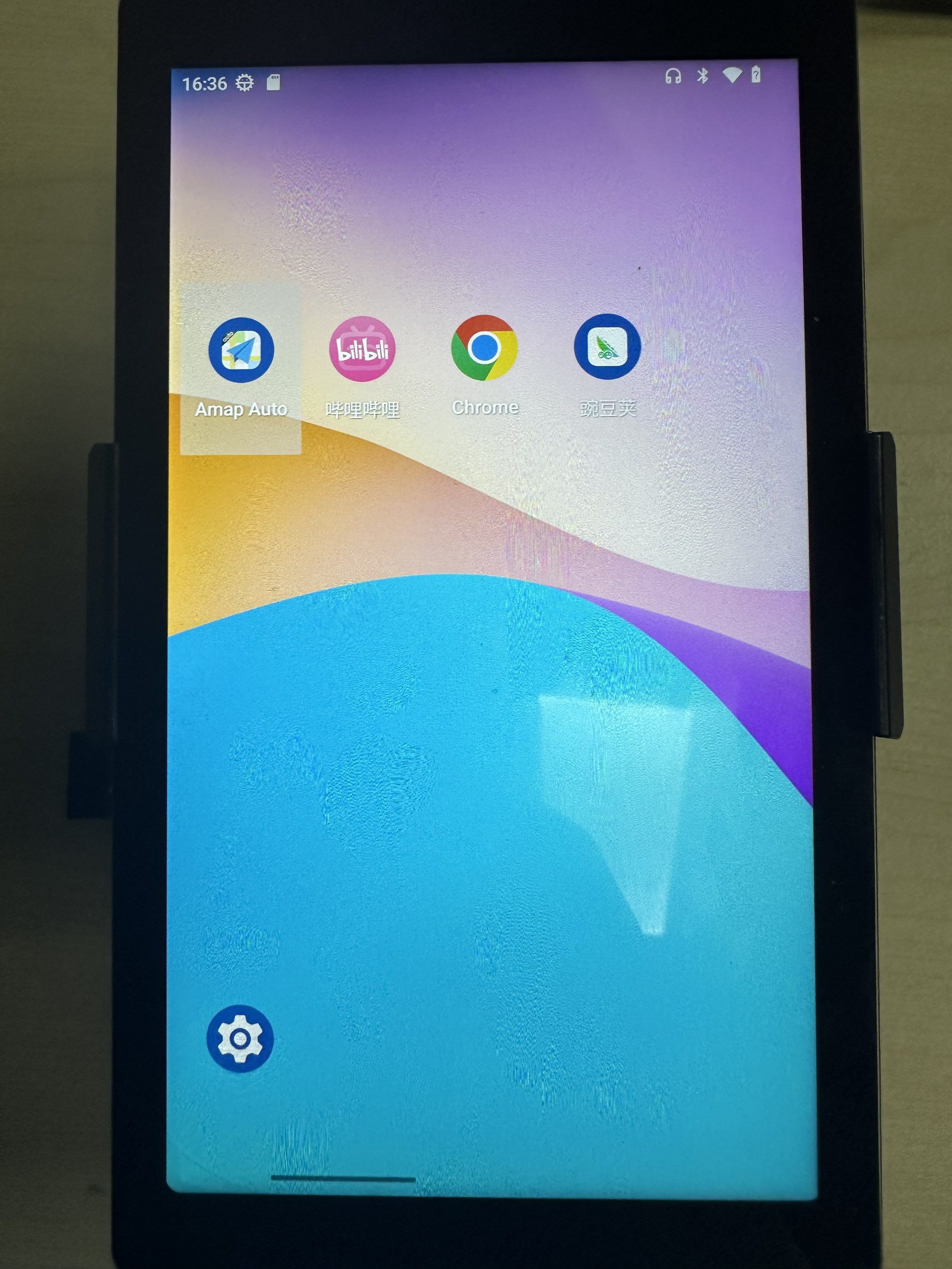

Once booted successfully, the Android system interface will appear.
start_up

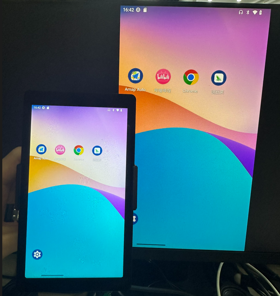

HDMI Monitor Mirroring
Simply connect an HDMI monitor to enable screen mirroring.

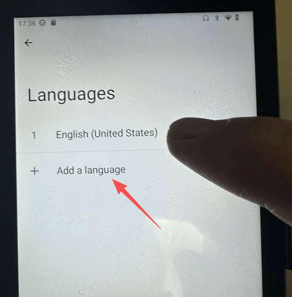

Then navigate to SystemLanguage & inputLanguages, as shown below. Then click Add a language.
start_up

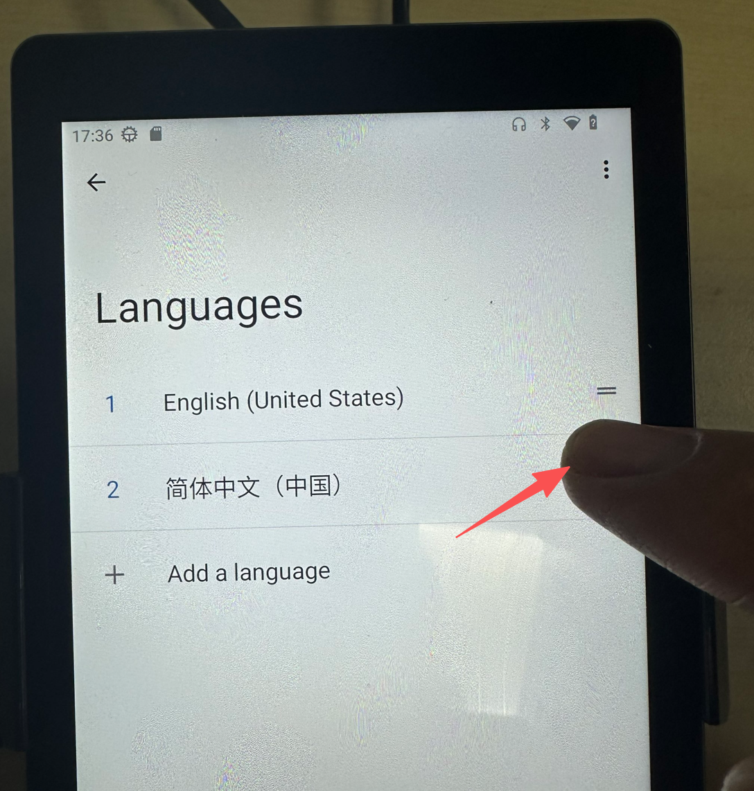

Select 简体中文 (Simplified Chinese):
start_up
Once it appears, press and hold the drag handle on the right, then drag Simplified Chinese to the very top.
start_up

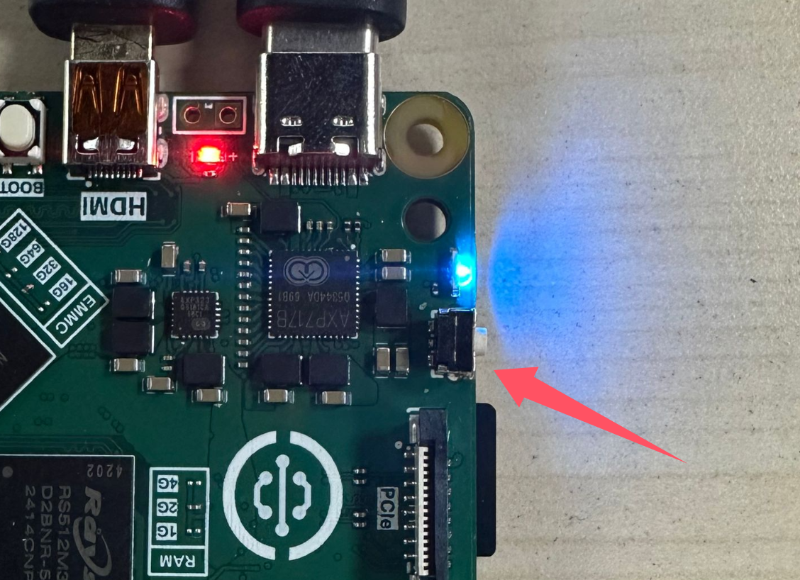

Long-press the development board button to bring up the shutdown options.
start_up
