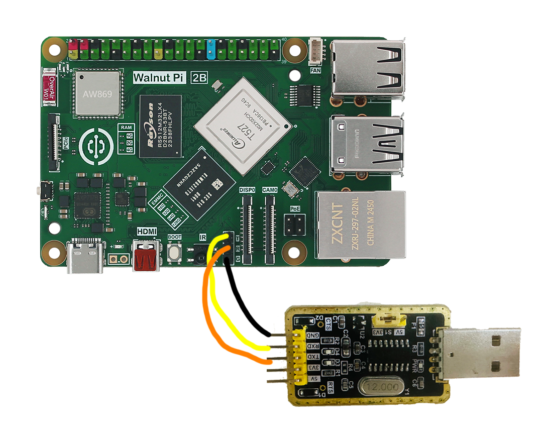

Opening Terminal via Debug Serial Port
Connect to the Walnut Pi's reserved serial terminal header pins using a USB-to-TTL adapter to your computer, then use terminal software like PuTTY to log in:
The debug serial header pins on the Walnut Pi 2B are labeled T, R, G, corresponding to TXD, RXD, and GND respectively.
You can use this feature to observe boot information when the system fails to boot normally. Note that TX and RX are cross-connected. USB TTL adapters with voltage switching must be set to 3.3V.
debug1
