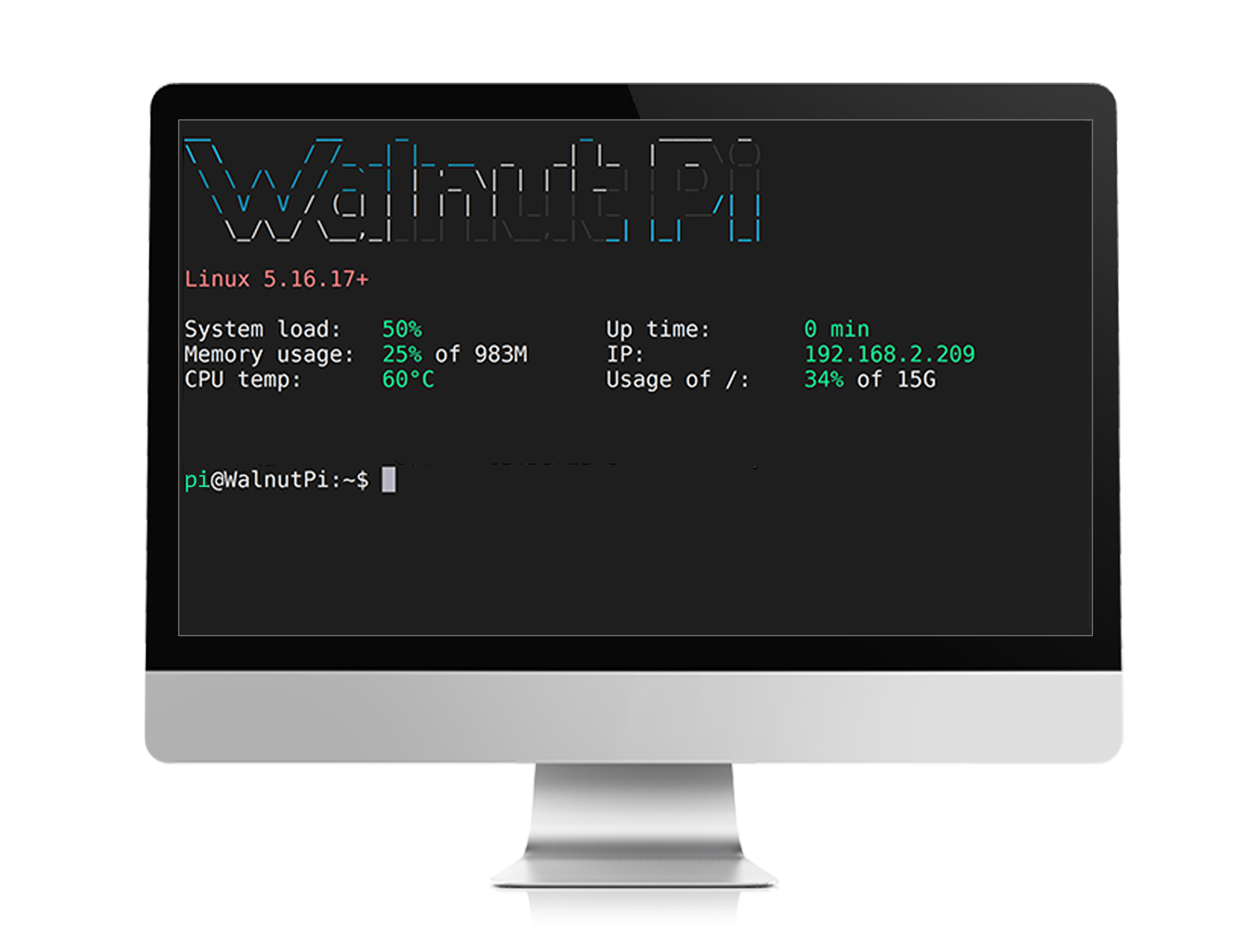

Login via HDMI Display
When the system boots normally, the blue LED will stay on. After successful startup, the desktop system displays the WalnutPi desktop, while the server (no-desktop) system displays a terminal.
Desktop System: Default pi user auto-login.
Server (No-Desktop) System: Requires entering username and password to log in.
