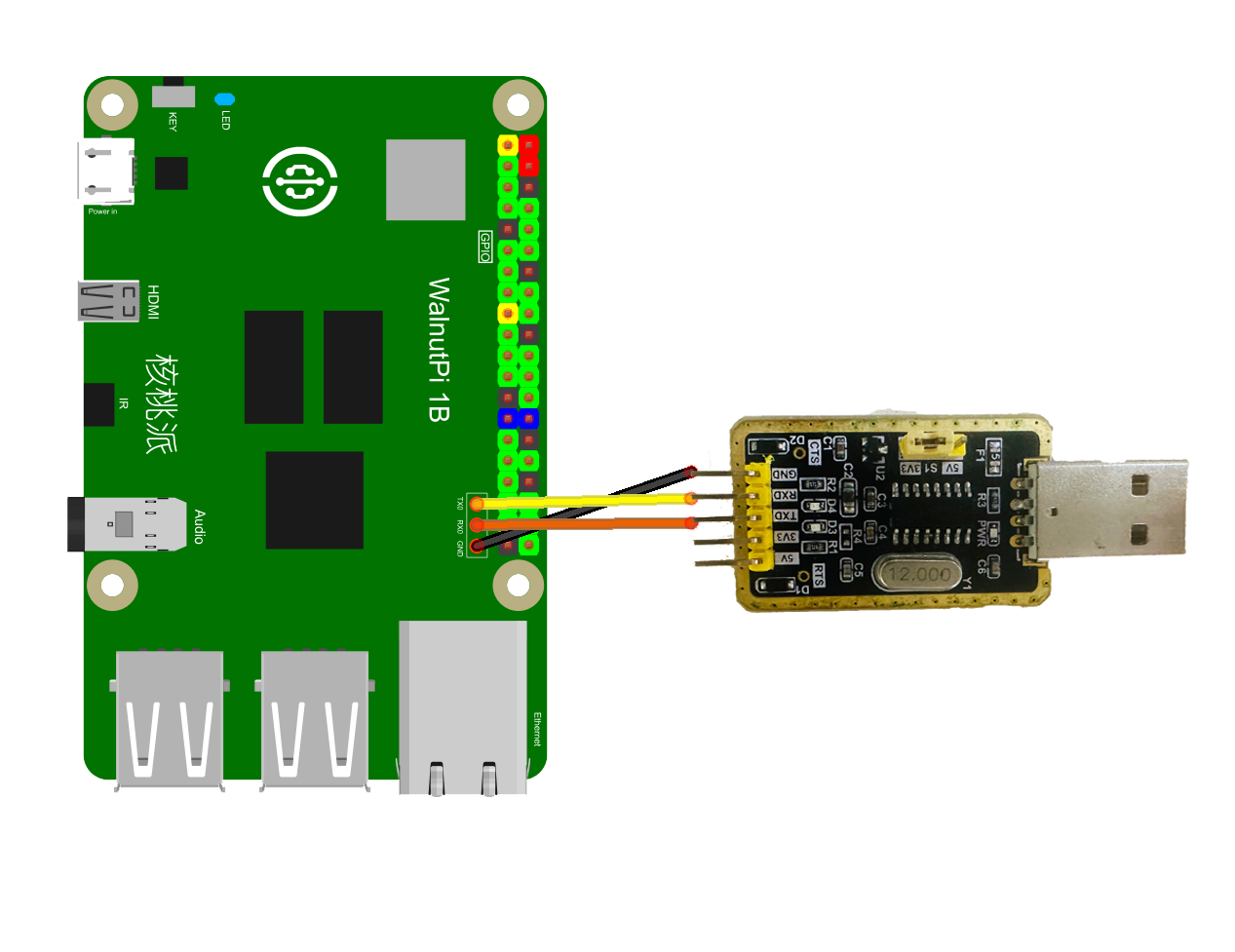

Opening Terminal via Debug Serial Port
Connect to the computer using a USB-to-TTL adapter via the serial terminal header pins reserved on the WalnutPi, then log in using terminal software such as PuTTY:
When the system fails to boot normally, you can use this feature to observe boot messages. Note that TX and RX are cross-wired, and USB TTL tools with voltage switching functionality must be set to 3.3V.
If you are using a ZeroW, you can connect via the expansion board's debug serial port, or modify the config.txt file to change the debug serial port number, enabling terminal output via uart2 on the 40-pin header. config.txt Debug Serial Port Settings Tutorial
