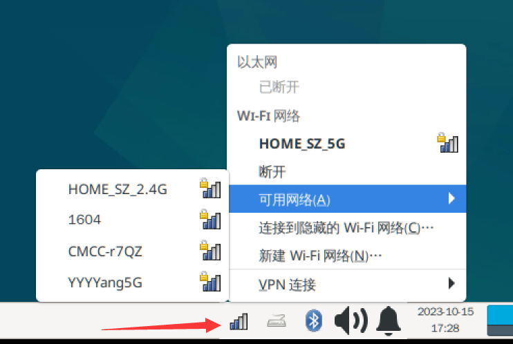

Desktop Button Connection​
On the desktop system, simply click the network button at the bottom right, select Available Networks, choose your WiFi network, and enter the password to connect.

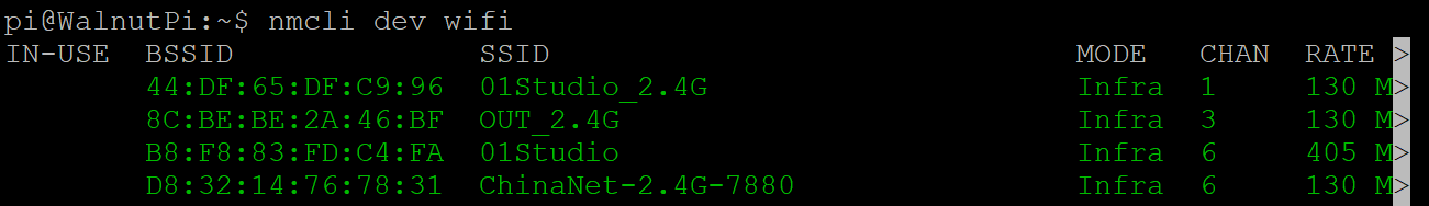

Connecting to WiFi via command line is suitable for non-desktop systems or scenarios where only terminal login is available. Here's how:
First, use the following command to get available WiFi SSIDs:
nmcli dev wifi
wifi2
Warning
Be sure to run the nmcli dev wifi command above to get WiFi information before proceeding with the next step to connect.
Press Ctrl+C or Ctrl+Z to interrupt the above command.

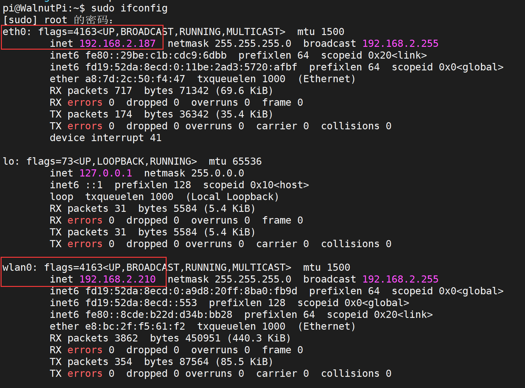

Then use the following command to connect to the specified WiFi (requires sudo administrator privileges). Below, "walnutpi" is the WiFi SSID and "88888888" is the password. Replace them with your own WiFi credentials.
sudo nmcli dev wifi connect walnutpi password 12345678
After successful connection, use the following command to check the WiFi connection status. An IP address indicates a successful connection.
sudo ifconfig
wlan0 indicates the WiFi connection, with the IP address below. eth0 indicates the Ethernet connection.
