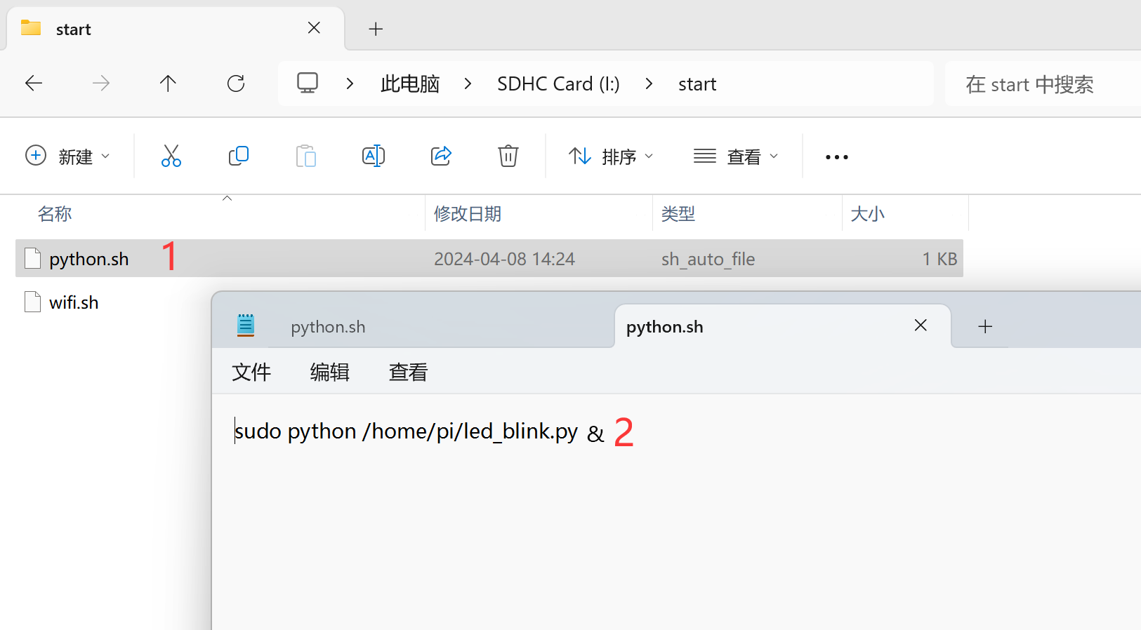

Then create a python.sh file in the /boot/start/ directory with the following content (indicating to run the led_blink.py file):
Adding & at the end of the command indicates running in a new thread, preventing Python programs with infinite loops from blocking the startup of other system services.
sudo python /home/pi/led_blink.py &

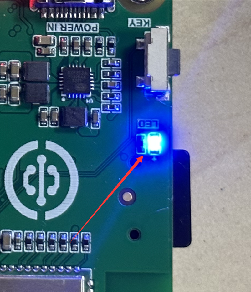

autorun
Insert the SD card into the WalnutPi board and start the system, or reboot the board. You will see the blue LED blinking after the WalnutPi starts, indicating the Python code has run successfully on boot.
