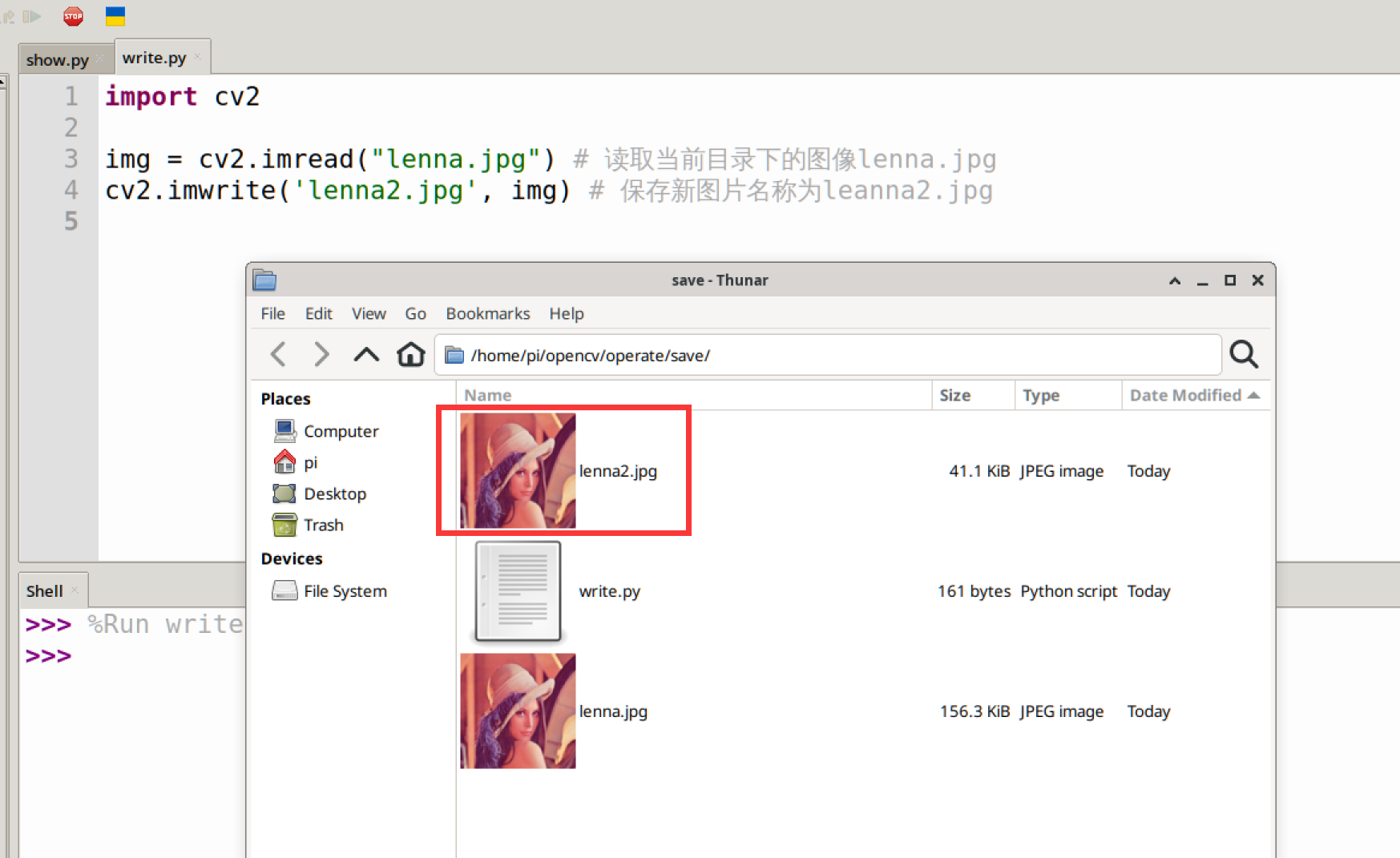

Here we demonstrate reading the image lenna.jpg and then saving it as lenna2.jpg. The reference code is as follows:
Experiment Name: Saving an Image
Experiment Platform: WalnutPi 1B
img = cv2.imread("lenna.jpg") # Read the image lenna.jpg from the current directory
The code execution result is as follows: an additional image named lenna2 appears in the current directory:
