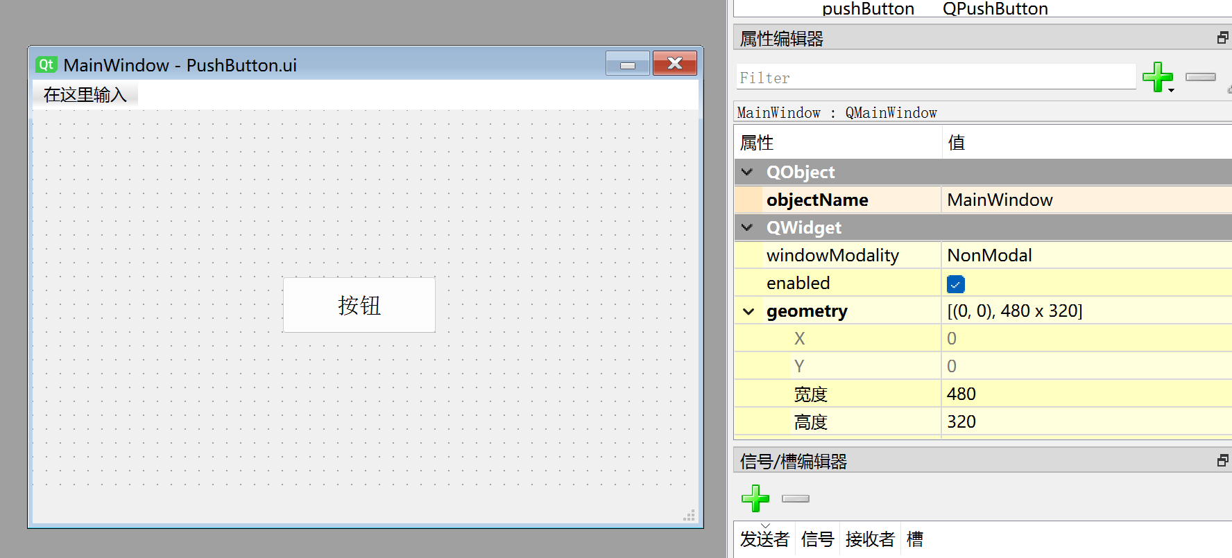

The PushButton widget is very commonly used and is called a button widget. It has press and release effects.
PushButton1
Editing a button is simple — double-click to modify the button text, and drag the edges to resize it. Font size, adding icons, and other settings can all be configured in the property panel on the right.
PushButton2
