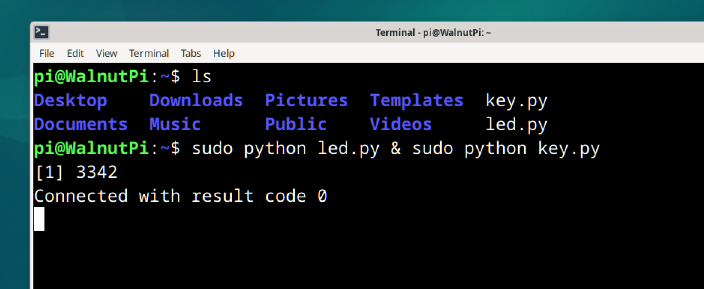

Copy the LED and button code from the above examples to the WalnutPi 1B development board. You can use the following command in the terminal to run both scripts simultaneously and register the entities with Home Assistant:
sudo python led.py & sudo python key.py

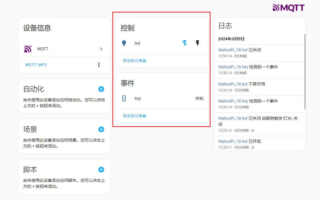

After successfully running the code, open the Home Assistant MQTT device section — you can see the 2 newly added entities:

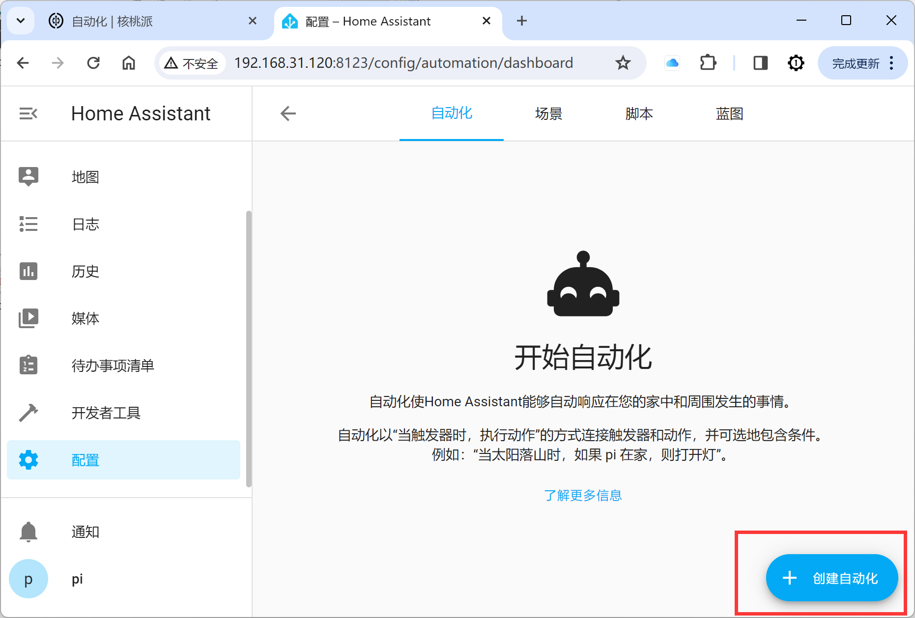

Next, let's set up the automation. Click Configuration -- Automations & Scenes:
automation
Then click Create Automation in the lower-right corner:
automation

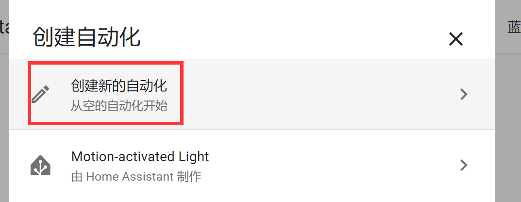

Click Create New Automation:
automation

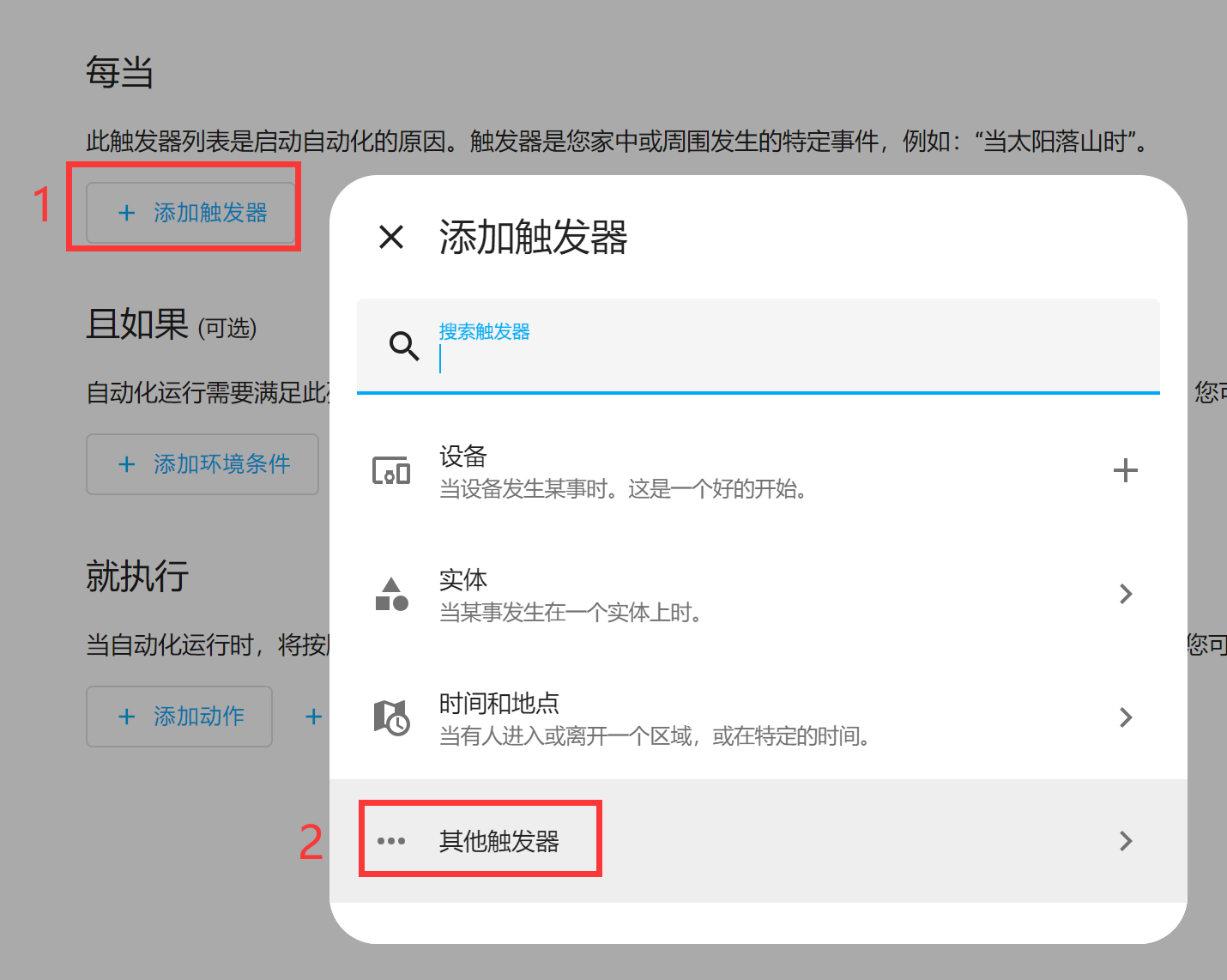

Click Add Trigger, then select Other Triggers: (Because Home Assistant's device triggers do not support button devices, we can use MQTT messages to trigger.)
automation

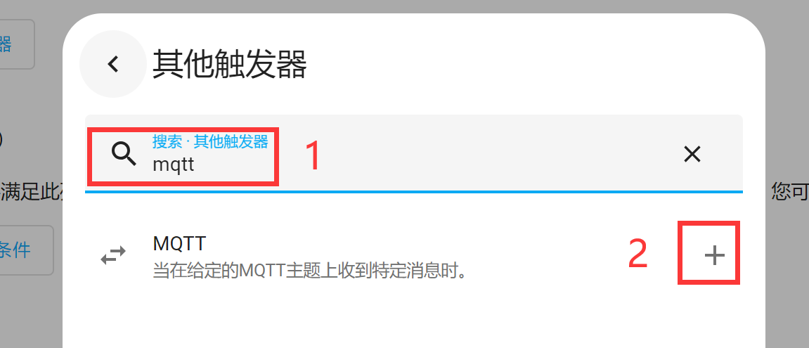

Search for "mqtt", then click + to add:
automation

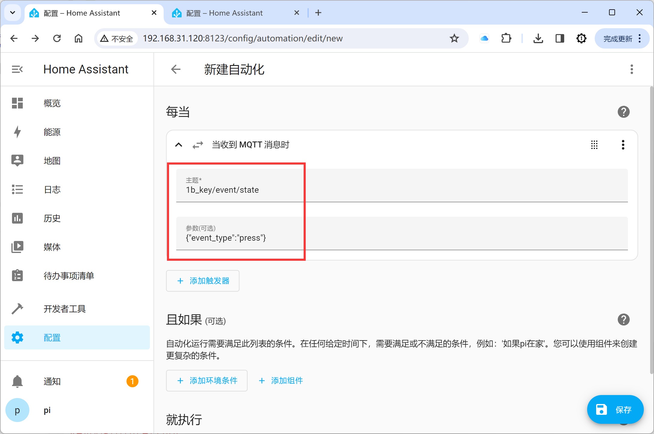

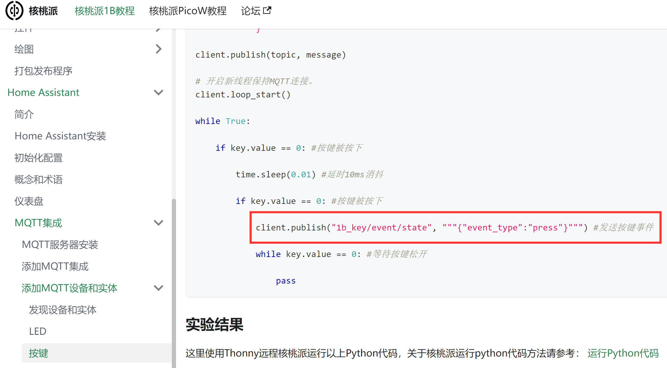

In the popup window, fill in the MQTT topic and message. From the Button experiment, you can see the topic and message published when the WalnutPi 1B button is pressed:
automation
MQTT Topic:
1b_key/event/state
MQTT Message:
{"event_type":"press"}
Fill in the above topic and message into the trigger:

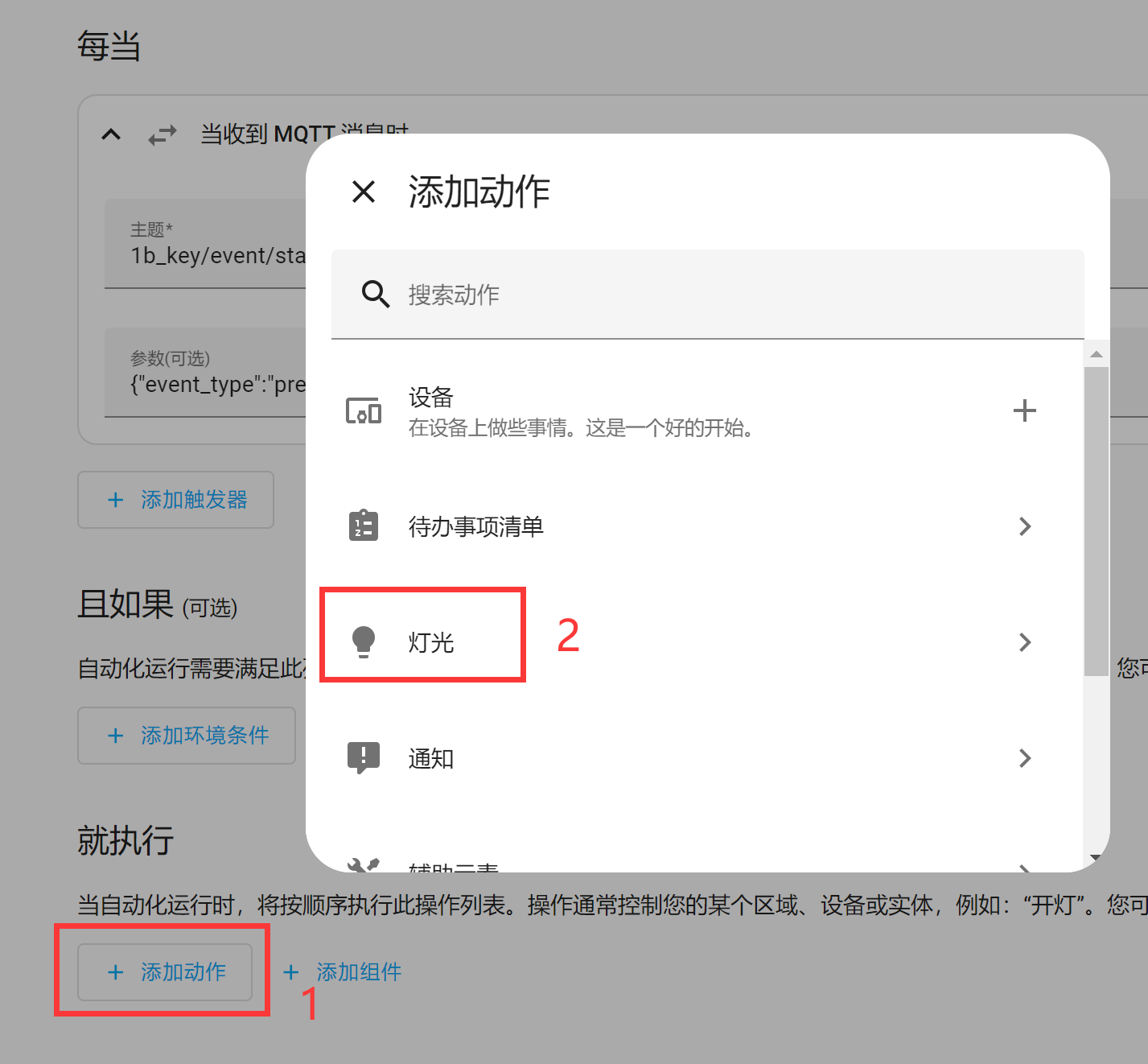

In the Then Do section below, click Add Action, then select Light:
automation
Select Toggle, which means each button press will toggle the LED state (on/off):
automation
