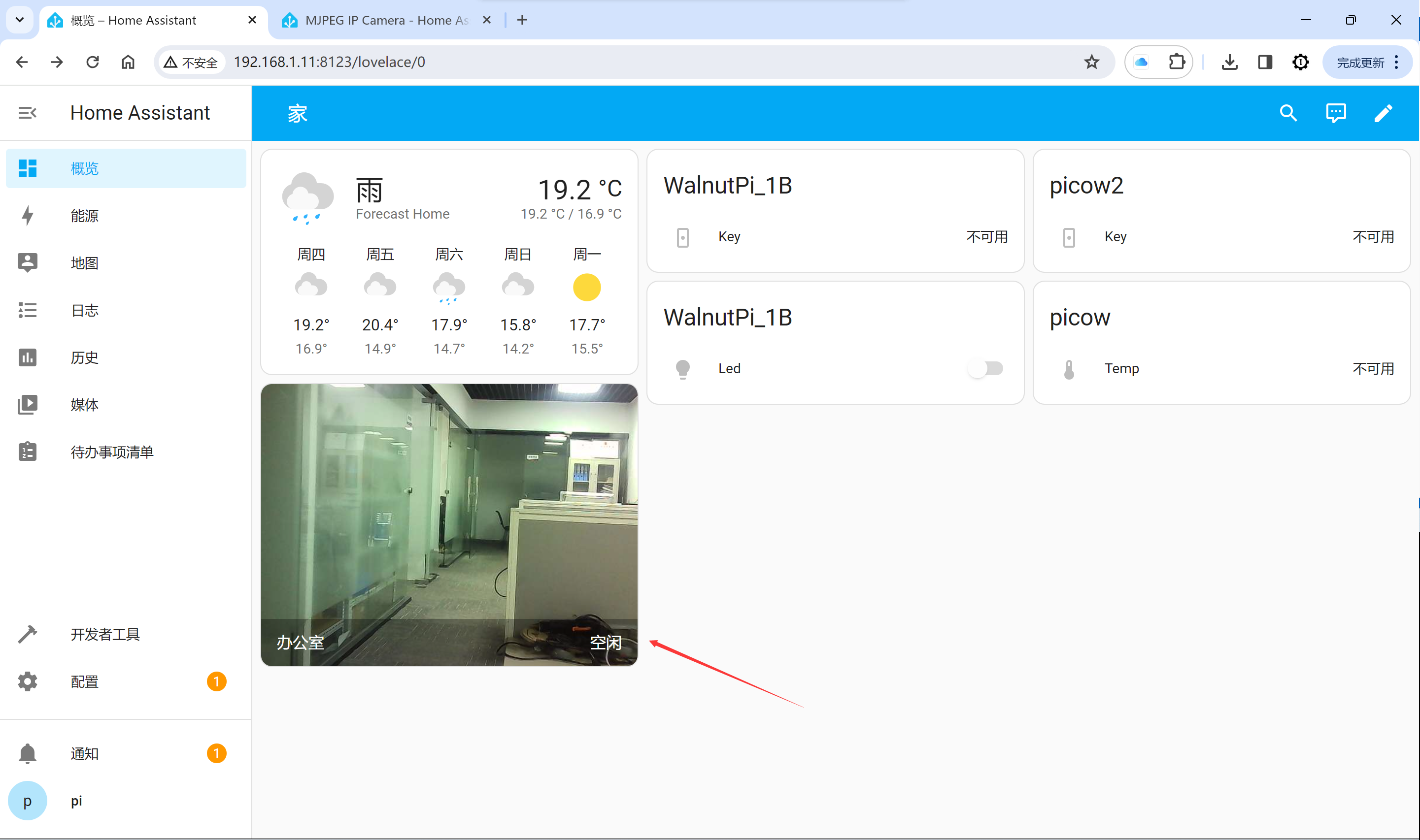

It can be added to the homepage dashboard:
After adding, you may find that the dashboard surveillance feed does not update in real time. Configure as follows to fix this:

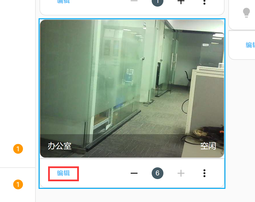

Click the small pencil button in the upper-right corner to enter card editing:
Click Edit in the lower-left corner of the surveillance feed:
Select camera view mode: live:

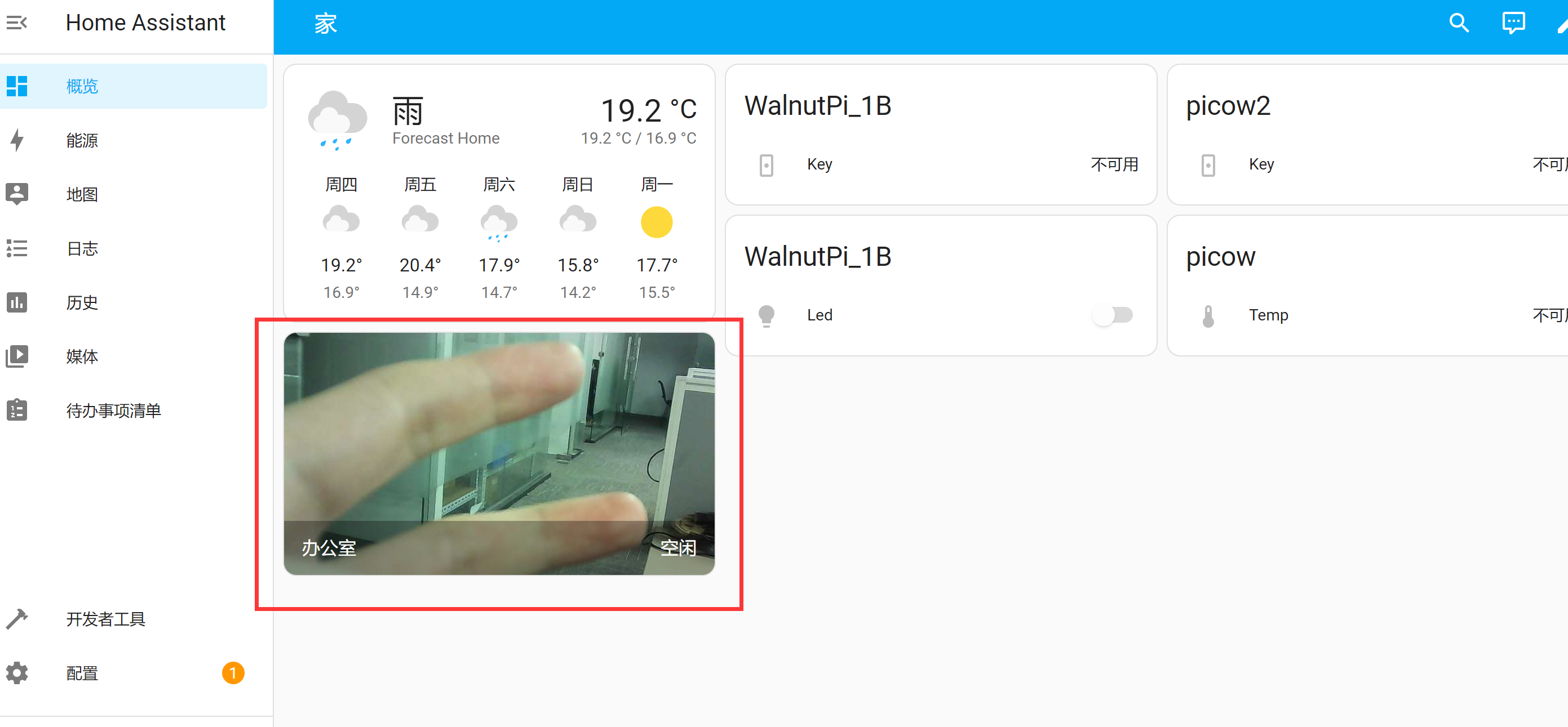

After completing and returning, refresh the webpage and you will see the camera feed updating in real time:
