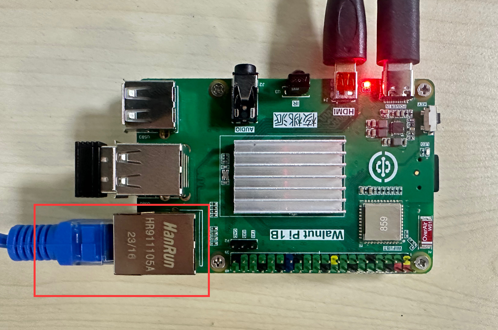

Via Ethernet
Connect one end of the Ethernet cable to the WalnutPi development board and the other end to the router.

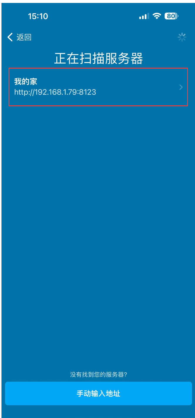

  • Open on Mobile
The benefit of using the app is that when your phone and Home Assistant are connected to the same router, it can automatically discover the Home Assistant host on the local network. Open the app and it will be discovered:

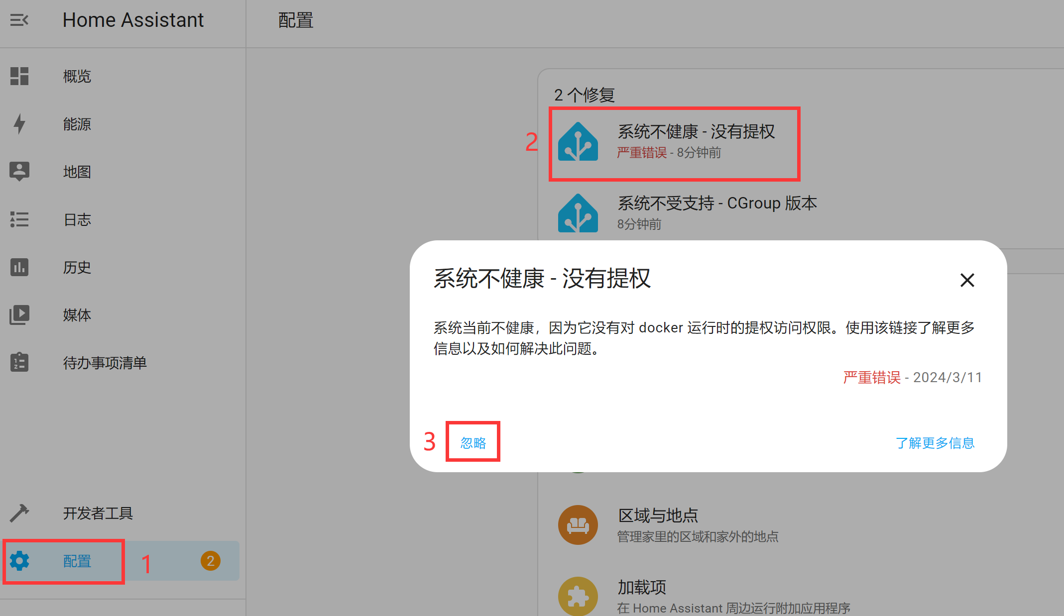

The prompt to fix Unhealthy System - Not Elevated is due to the initial boot from the image — just click Ignore. Note that after ignoring, you need to restart the host, otherwise online updates and some plugin installations will not work.
Restart Methods:
  1. Execute sudo reboot via the WalnutPi terminal to restart.
  2. Long-press the button for more than 6 seconds to shut down, then disconnect and reconnect power to restart.
Directly cutting power to restart is not recommended, as some unsaved content may be lost.

The prompt to fix Unsupported System - CGroup Version — just click Ignore:
