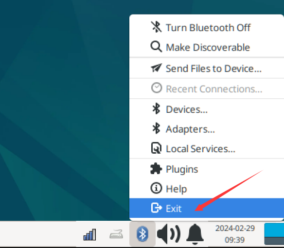

Warning
When using Home Assistant on the WalnutPi Desktop Edition system, you need to close the BlueMan Bluetooth application and disable it from starting at boot. This application conflicts with Home Assistant's Bluetooth calls, causing continuous memory leaks. (This operation is required for manual installation; Home Assistant images have this disabled by default at the factory.)
